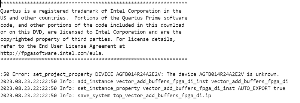

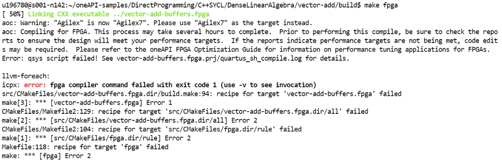

I'm unable to compile for fpga on devcloud. I have tried it on already existing samples on devcloud as well as on my own projects.
I'm running in interactive mode. I connected to an fpga node using
qsub -I -l nodes=1:stratix10:ppn=2 -d .
This is what i'm getting in quartus_sh_compile.log
p.s. - This error is only when i try to compile for fpga hardware using make fpga . I am able to compile for emulator using make fpga_emu
