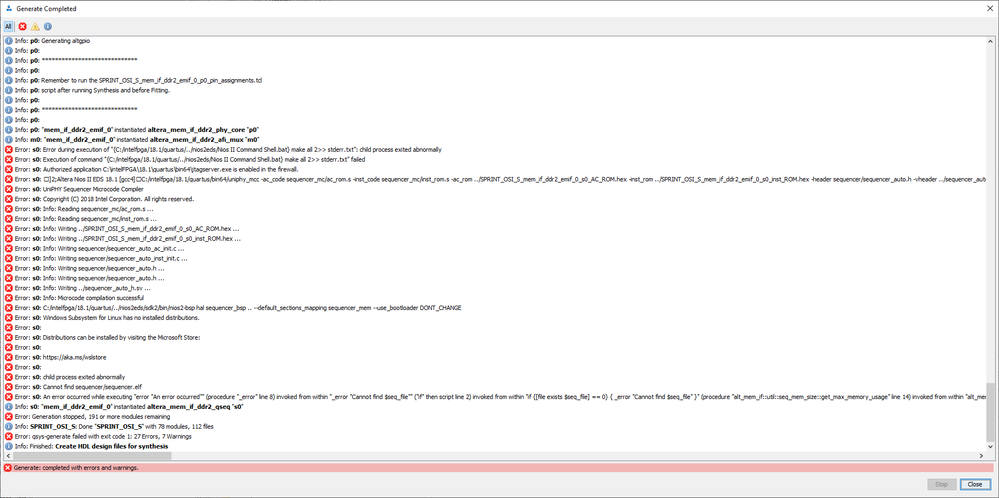

Qsys fails with strange error messages never seen before
Here is the screen shot:
I have attached text file containing the dump. I am not sure why this error has occurred.

- sstrell
At first I thought it was the issue that WSL is now required for the Nios command shell, but you are using 18.1, so it can't be that. Maybe: https://www.intel.com/content/www/us/en/programmable/support/support-resources/knowledge-base/tools/2020/error--execution-of-command----quartusinstallation--nios2eds-nio.html?wapkw=nios%20command%20shell%20wsl

- gyuunyuu
Contributor
This Qsys system has generated fine in the past so I am not sure what happened. I shall try out the fix and let you know.
