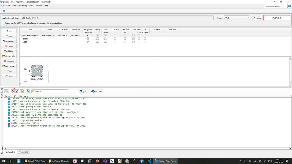

    • frwo's avatar
      frwo
      Sure... here we go:

    • frwo's avatar
      frwo
      Hi Fakhrul,
      please excuse the late feedback.
      Enabling "Enable real-time ISP to allow background programming when available"
      is fixing the problem but prolongs the flashing considerably.
      Moving to another PC did not help!
