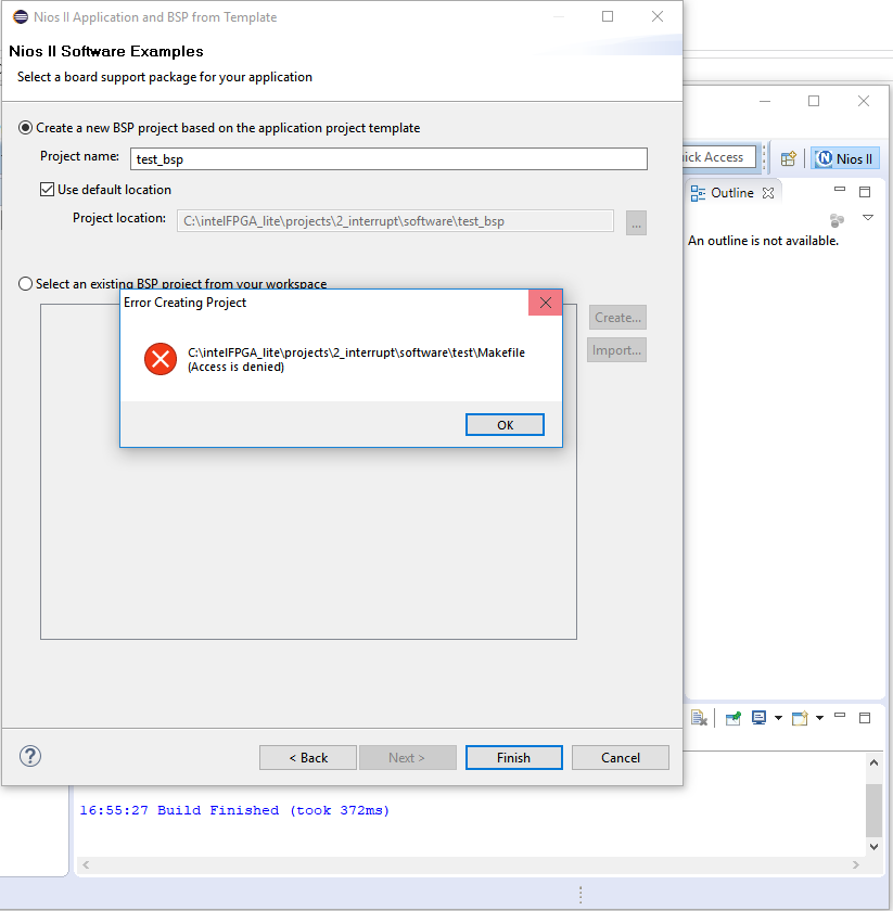

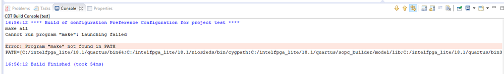

Hi KTan9,
I have been trying for few days upgrading from quartus 16.1 to 18.1 Lite. I installed the software and the updates and can successfuly compile my project in quartus. However, when I want to create a new project with BSP in Nios 18.1, I get the error below. I get the error for all the templates. Do you know a workaround? Thanks again for all your help,
- KennyT_altera
This usually happened if you do not create the bsp as the admin. If still not solve, you can post this new question to the correct area
