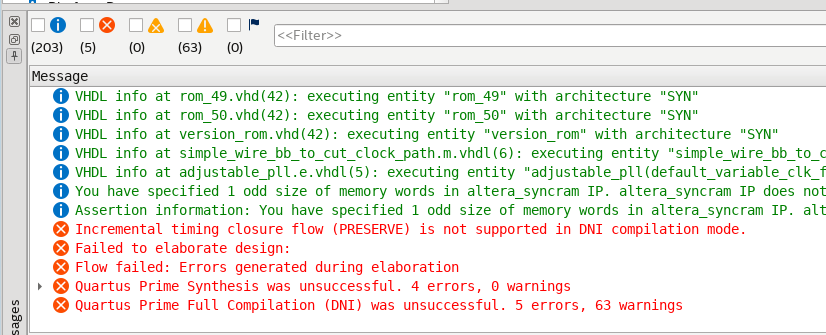

    I also tried with the --dni,
    it does not support the preserve final (or synthesized), see picture.
