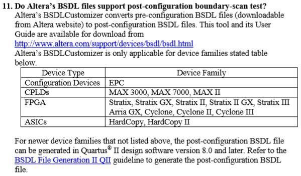

I need assistance generating post-configuration BSDL files for the legacy Intel/Altera Flex 10K family of FPGAs. I found a “BSDL_FAQs” document on Intel’s website that has a description below of their “BSDLCustomizer” tool used for generating post-configuration BSDL files. The Flex 10K family is not listed as a device type supported by this tool.

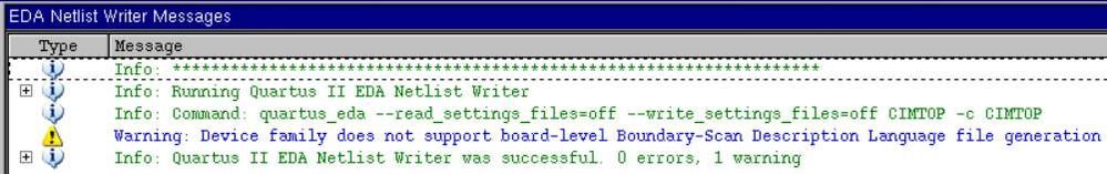

I have compiled the firmware in Quartus 9.0 which supports the FLEX10K device family and has a post-configuration BSDL writer capability. When I try to run the BSDL writer on the project, I get this message:
The warning message is "Device family does not support board-level Boundary-Scan Description Language file generation". As a result, no post-configuration BSDL file is generated.

Apologize that we do not have tool to generate that can be used to generate post-configuration files.
Since "BSDLCustomizer” tool is not supporting FLEX 10K and 10KA FPGAs, thus we cant generate post-configuration BSDL file.
