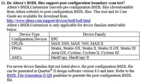

I need assistance generating post-configuration BSDL files for the legacy Intel/Altera Flex 10K family of FPGAs. I found a “BSDL_FAQs” document on Intel’s website that has a description below of the...

Apologize that we do not have tool to generate that can be used to generate post-configuration files.
Since "BSDLCustomizer” tool is not supporting FLEX 10K and 10KA FPGAs, thus we cant generate post-configuration BSDL file.
