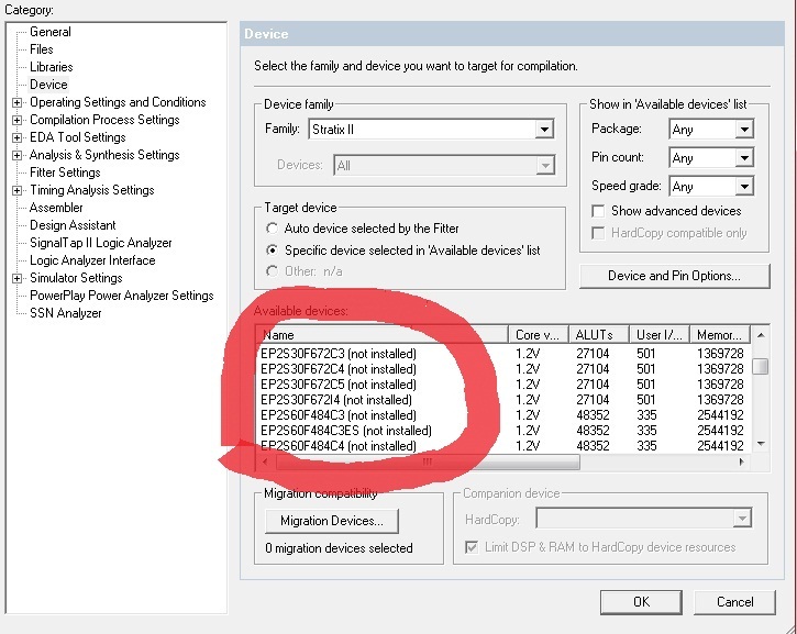

Please Help me to solve the problem thank you
As the attached picture shows, I want to use the "not installed" device, how can I do it? Thank you!

    What version of the software are you using? If you are running the subscription edition, you need to re-run the installation and make sure that the device family is selected for installation.

    That' because when you install quartus ii, some devices you do not check to install. So you can reinstall quartus ii and check those devices to install. Default is that all devices be checked to install.

    the Web Edition does not support the "not installed" devices.
