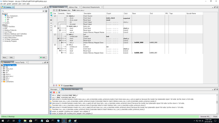

I'm creating my custom "CPU" and peripherals with Platform Designer, and connecting them using Avalon Memory-mapped bus. For simplicity, my CPU always uses and transfers 32-bit data, and there are ...
- 8 years ago
It seems that (almost?) all existing components in stock library requires 8 bits per symbol; it doesn't allow to connect components that have different bits per symbol width.
So, I withdraw this question, and will change bits per symbol value to 8.
