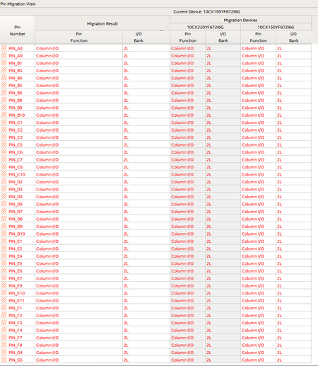

Hello, I am using Pin Planner to verify the pin compatibility between C10GX150 and C10GX220. I saw high lightened pins in bank 2L for unknown reason, please forward to attachment. Should I s...

Pin function or I/O back column will be NC.
- We have to Compare the PINOUT file and find the difference and check it with respect to pin connection guidelines
- If we are doing Quartus design migration we can change the device PN and compile the design and check.

7 years agoHi Anad,
Thank you for getting back.
I am using Quartus Prime Pro Edition Ver. 18.0.1 Build 261 for the fit.
If the migration has problem, what message it will show to indicate the error?

7 years agoHi,
