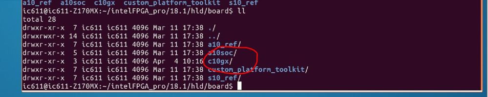

- DongWang-BJTU
18.1 version has the bsp for c10gx, you can find it under the directory intelFPGA_pro/hld/board.

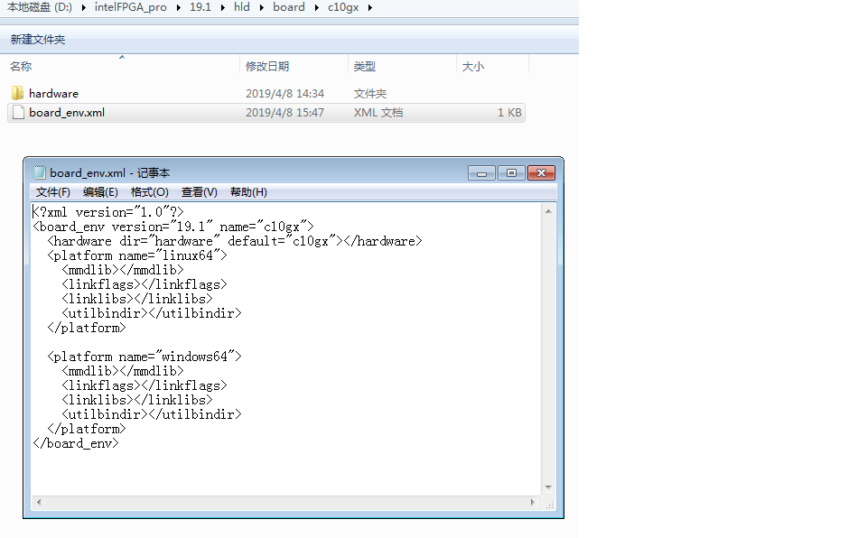

- lking3
I've installed the AOCL Pro 18.1 for windows, and found the directory "intelFPGA_pro/18.1/hld/board/c10gx" ,but there were only a "hardware" directory and an empty board_env.xml file in it, no other subdirectories. And when I run the aocl install command,it shows:"no board installation routine supplied". I thought it was due to lacking of files. Have you ever met the problem

- FawazJ_Altera
Hello, Currently, the available OpenCL BSP is targeting these boards: Cyclone V SoC, Stratix V, Stratix 10 GX, Arria 10 GX, and Arria 10 SoC. Thanks- lking3

- FawazJ_Altera
Hello sir, There is no plan yet to support OpenCL BSP for Cyclone 10 GX. Thanks
