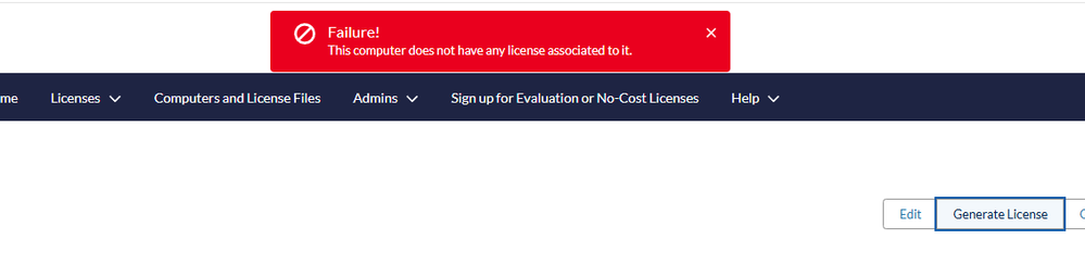

In June 2026, I have generated one license for the Questa-Intel FPGA Starter Edition 2023.2 on my old computer.
And today I got a new computer and I have created a new Host with the new Computer Name, Computer Type,  License Type, Primary Computer ID.
When I clicked Generate License, I got this error :
Is there anyone who knows how to solve this issue?
Thank you very much

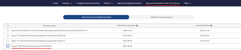

  • I received your private message. The Questa FPGA Starter Edition license is a no-cost license, so there is no need to rehost your existing license.
    You can generate a new license by following these steps:
    1. Go to Sign Up for Evaluation or No-Cost Licenses on the Altera SSLC portal.
    2. Select Questa FPGA Starter Edition from the list of available no-cost licenses.
    3. Enter the Host ID (NIC ID) of the machine where you intend to use the license.
    If you encounter any issues during license generation, please let me know and share screenshots of the steps where the process fails.
    Richard Tan
5 Replies
    Richard Tan
