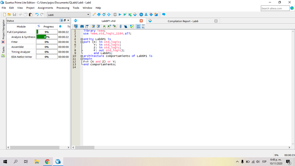

Good morning, thank you very much for helping me, I am worried because the Quartus is the controller of the Altera Cyclone IV card. I have reinstalled the Quartus 3 times, I gave it permissions so that the antivirus can avoid deleting its files. Before installing it, for the third time, I deleted the temporary files. Quartus doesn't compile! It always gets up to 47%. Any ideas? Thank you very much.

Your file is named lab6, but your entity is named Lab6P1. The names have to match.

Are there any messages in the Messages window (reopen from View menu)? Was the design file added to the project and set as the top-level entity (check the Project Navigator which is also closed)?

Good morning, thank you very much for helping. I checked the "messages" and it comes out:
Error (12007): Top-level design entity "lab6" is undefined
Error: Quartus Prime Analysis & Synthesis was unsuccessful. 1 error, 1 warning
Error: Peak virtual memory: 4784 megabytes
Error: Processing ended: Wed Nov 11 07:09:08 2020
Error: Elapsed time: 00:00:17
Error: Total CPU time (on all processors): 00:00:43
Error (293001): Quartus Prime Full Compilation was unsuccessful. 3 errors, 1 warningScreenshot attached:
Thank you very much for the help you can give me.
