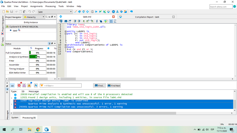

Your file is named lab6, but your entity is named Lab6P1. The names have to match.
Are there any messages in the Messages window (reopen from View menu)? Was the design file added to the project and set as the top-level entity (check the Project Navigator which is also closed)?
Good morning, thank you very much for helping. I checked the "messages" and it comes out:
Error (12007): Top-level design entity "lab6" is undefined
Error: Quartus Prime Analysis & Synthesis was unsuccessful. 1 error, 1 warning
Error: Peak virtual memory: 4784 megabytes
Error: Processing ended: Wed Nov 11 07:09:08 2020
Error: Elapsed time: 00:00:17
Error: Total CPU time (on all processors): 00:00:43
Error (293001): Quartus Prime Full Compilation was unsuccessful. 3 errors, 1 warning

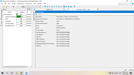

Screenshot attached:
Thank you very much for the help you can give me.
