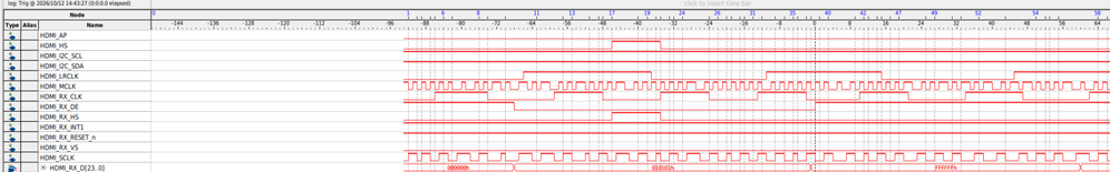

The gap is normal behaviour. I test the example design with don't care triggering points and i get gap like below:

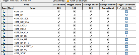

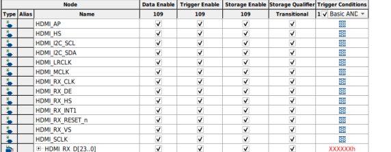

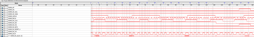

When I set the rising edge triggering points like below:
In first picture, there's no trigger point (don't care) so the 0 is at the beginning. In second picture, the rising edge trigger point is being set and the 0 is at the rising edge and there's waveform at the negtive time frame before 0.
The gap mean there's no waveform at that point. The gap will be reduced if the sample depth is reduced.
