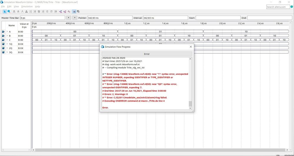

my scheme simulation is ok , but test have errors
# ** Error: (vlog-13069) Waveform.vwf.vt(40): near "1": syntax error, unexpected INTEGER NUMBER, expecting IDENTIFIER or TYPE_IDENTIFIER or NETTYPE_IDENTIFIER.
# ** Error: (vlog-13069) Waveform.vwf.vt(50): near "Q0": syntax error, unexpected IDENTIFIER, expecting ')'.
# End time: 20:57:29 on Jun 10,2021, Elapsed time: 0:00:00
# Errors: 2, Warnings: 0
# ** Error: C:/Q2011/modelsim_ase/win32aloem/vlog failed.
# Executing ONERROR command at macro ./Trite.do line 4
Error.

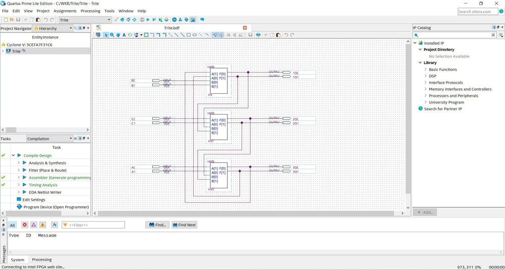

  • Nurina's avatar
    Nurina
    These errors mean there are errors in your verilog/VHDL code.
    From the bdf I can see that your output signal names start with a number. This isn't allowed in verilog/VHDL and you need to rename them starting with an alphabet.
    Error: (vlog-13069) Waveform.vwf.vt(50): near "Q0": syntax errir, unexpected IDENTIFIER, expecting ')'.
    I can't tell why you get this error from your bdf. Can you attach the "Waveform.vwf.vt" file?
