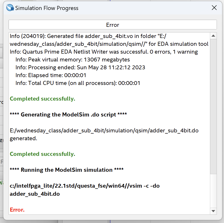

My device is a Macbook Pro 14' with an M1 chip. I have installed Parallels Desktop 18 for Mac Standard Edition (version 18.2.0) on my computer. I have also created a 64-bit ARM version of Windows 11 (22H2) and successfully installed Quartus Prime Lite Edition (22.1std.0.915) on it.
I can successfully open Quartus II and perform tasks like creating projects and compiling. However, I am unable to run simulations. It works on other computers, but here I only get an error message.
As an example, let's consider a simple half adder. The following error message appears when trying to run the simulation:
Determining the location of the ModelSim executable...
Using: c:/intelfpga_lite/22.1std/questa_fse/win64/
To specify a ModelSim executable directory, select: Tools -> Options -> EDA Tool Options
Note: if both Questa Intel FPGA Edition and ModelSim executables are available, Questa Intel FPGA Edition will be used.
**** Generating the ModelSim Testbench ****
quartus_eda --gen_testbench --tool=modelsim_oem --format=verilog --write_settings_files=off adder_sub_4bit -c adder_sub_4bit --vector_source="E:/wednesday_class/adder_sub_4bit/Waveform1.vwf" --testbench_file="E:/wednesday_class/adder_sub_4bit/simulation/qsim/Waveform1.vwf.vt"
TBBmalloc: skip allocation functions replacement in ucrtbase.dll: unknown prologue for function free

**** Running the ModelSim simulation ****
c:/intelfpga_lite/22.1std/questa_fse/win64//vsim -c -do adder_sub_4bit.do
Error.
  • Check the path to Questa in your Quartus EDA settings. There's an extra slash there "/".
  • sstrell's avatar
    sstrell
    • bubniak's avatar
      bubniak
      Could you please share your solution? I currently have the same issue, and fixing the Questa path did not solve it.
