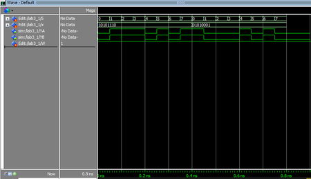

i have a little problem with my manager input ( W ) i can't find TIME PERIOD for my project ( For W )
( On photo W have constant 1, but in project it have change beatwen 0 and 1 )
So, if s...
sstrell
3 years agoW is coming from an input pin so its period/frequency would depend on whatever is driving that input from the board, outside the FPGA. There's no info here to determine that.
