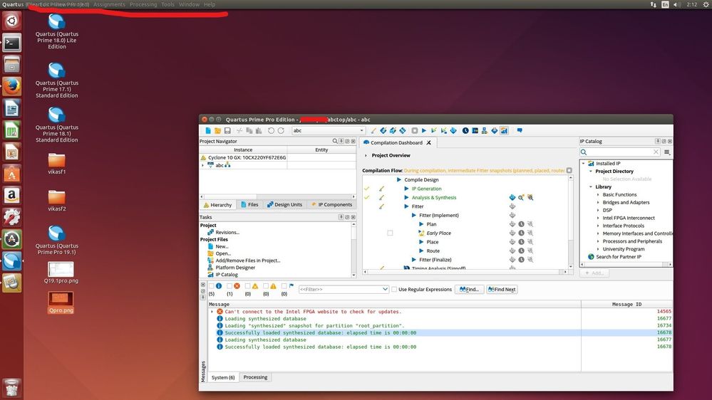

I installed Quartus 19.1 Pro on Linux machine but I can not see the Menu Bar.

    ​Hi,
    Yes, I tried by reinstalling & I realized the unexpected behavior of Menu bar of Q19.1 pro, but I couldn`t find that issue with Q18.0 lite, Q17.1 & Q18.1 std installed on same machine.
    Check the highlight part in screenshot

    ​Hi,
    Ubuntu 14.04.5 LTS
