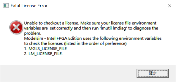

Missed to generate ModelSim FEATURE in my license file
Recently, my license file was expired. So, I went to re-generate my license file again. However, I found it generate the empty ModelSim FEATURE as follows in my license file:
# FEATURE START
# The following is a license file for the ModelSim
# FEATURE END
Then, I got failed to run ModelSim with the below Fatal License Error:
  • CasperChen's avatar
    CasperChen
    4 years ago
    Right now, I can run ModelSim with the above new license file LR-083849.
    I found that ModelSim needs the license file name used with MGLS_LICENSE_FILE/LM_LICENSE_FILE is as same as that used in "Quartus --> Tools --> license setup...".
    Basically, the new license file generated with all features can fix the root cause.

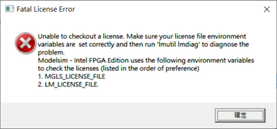

      Today, I tried to re-generate my license file. The new license file was generated with all features compared to my old license file. BUT, it still got failed to run ModelSim with the below Fatal License Error:
        CasperChen
