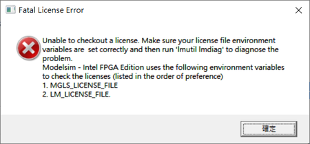

Thanks. The attachment is my new license file re-generated on today, and I still got failed to run ModelSim as below:

Right now, I can run ModelSim with the above new license file LR-083849.
I found that ModelSim needs the license file name used with MGLS_LICENSE_FILE/LM_LICENSE_FILE is as same as that used in "Quartus --> Tools --> license setup...".
Basically, the new license file generated with all features can fix the root cause.
