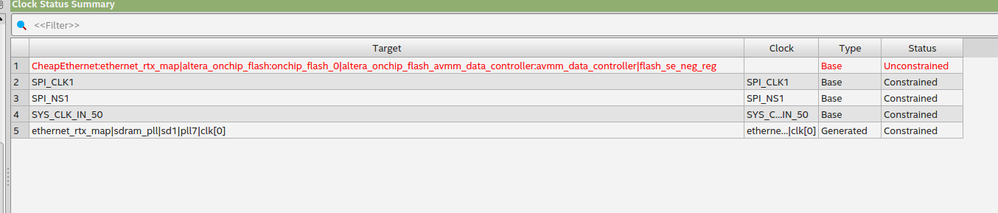

MAX 10 constraint error reported to on chip flash clock.
Hi, I prepared a lot more of issue but I am weakened about...
This one is really out of my control:
On chip flash clock is attached to pll C0 as all peripheral are. In same pane, 1 and 5 share same clock, so why this error?

There is one KDB about this. Can you try the workaround stated in https://www.intel.com/content/altera-www/global/en_us/index/support/support-resources/knowledge-base/tools/2016/warning--332060---node---alteraonchipflash-onchipflash-alteraonc.html?
- RRomano001
Contributor
Hi YY, yes seems solve issue but not side effect. We can address this and other after fair event is coming too soon to experiment.
