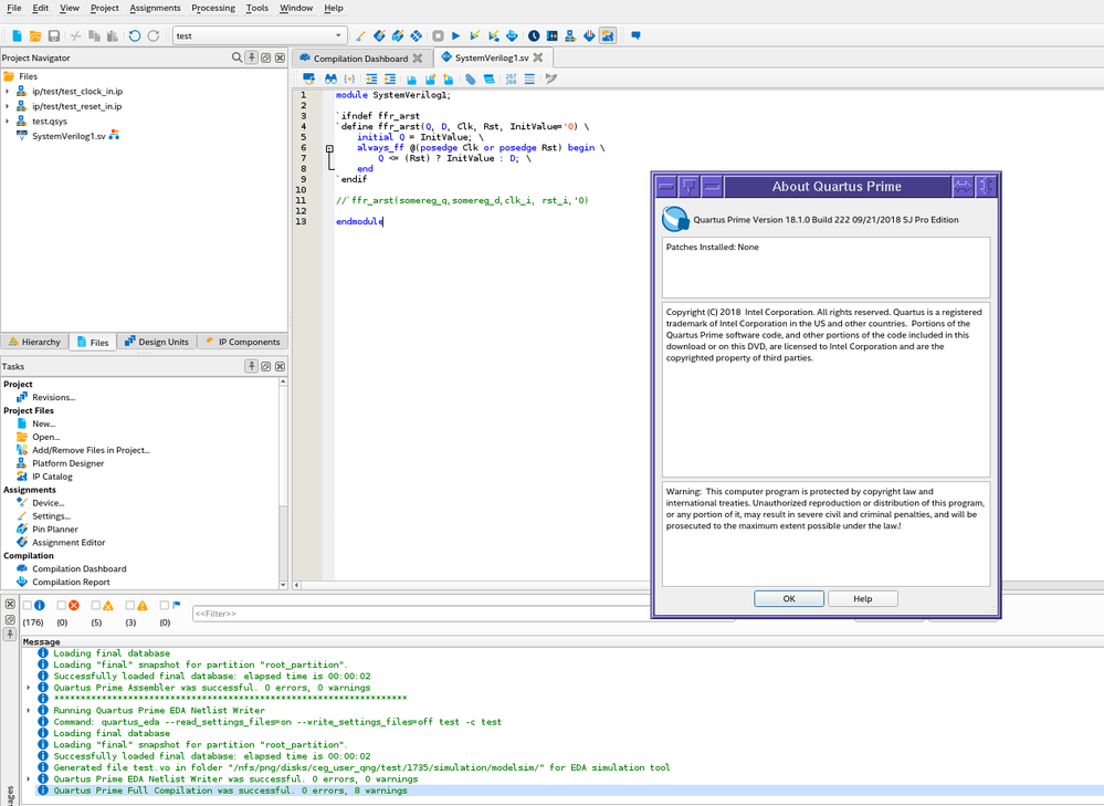

This feature is supported in pro version but not standard version check image below:
Hopefully answering your doubts.

Thank you @ShengN_Intel , that answered my question.
