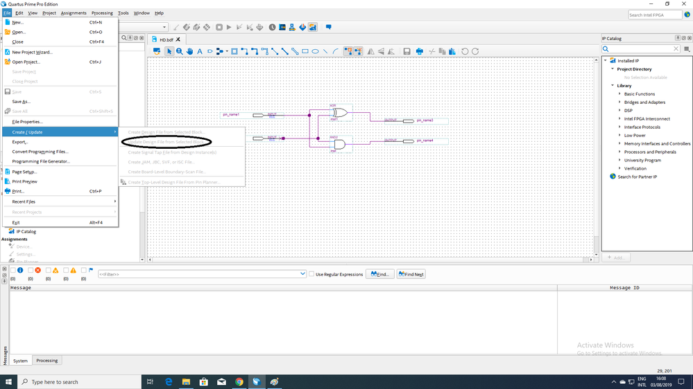

7 years agoMọi người cho em hỏi tại sao em không update được thiết kế ạ. Cám ơn mọi người ạ

fix error: symbol cant be updated for the logic ( FA, HA )

- KhaiChein_Y_Intel
Could you explain the error in details? Any screenshot of the error?

May I know which version you are using?
- LĐứcH
19.2
- KhaiChein_Y_Intel
I have reported this to engineering team. You may manually create / update the design file as a workaround at the moment.
(1507344560)
- KhaiChein_Y_Intel
The menu will be enabled with a selected block. Please refer to https://www.intel.com/content/www/us/en/programmable/quartushelp/17.0/design/ged/ged_com_create_design_file.htm.
