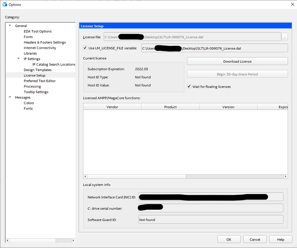

I wanted to do logic simulation with Quartus (Quartus Prime 21.1) Lite Edition, but I got the following error.
Error: Can't launch Questa Intel FPGA Simulation software -- make sure the software is properly installed and the environment variable LM_LICENSE_FILE or MGLS_LICENSE_FILE points to the correct license file.
Error: NativeLink simulation flow was NOT successful
Any ideas what could be causing the error?
  • SyafieqS's avatar
    SyafieqS
    Did you properly setup the license? Lite is free but still need license, You need to generate in SSLC and specify the location or using env variable. Also please make sure the path in quartus calling Questa in correct

  • jj16's avatar
    jj16
    Sorry for the late reply.
    I understand the above matter.
    Thank you for your response.
