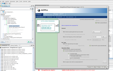

Issue is about some TCL error I cannot address, Verilog VHDL is just the generated design hardware.
Openiing the design file by hand then set the PLL block, refresh design and then load with all clock, generate correct IP core. Platform designer provided interface DOESN'T WORK!!! INTERFACE, SOFTWARE ISSUE, not HDL generated file.
See snapshot, see what happen to saved PLL has just one clock C0 is on module, where set up C0, C1, C2, input frequency is not 100MHz default MUST BE 50MHz, Optput need be what I select and MORE THAN ONE I repeat REPEAT C0, C1, C2...
Software code messed up is graphic interface, if you open is stretched and if you touch something it crash after a while. Resizing doesn't crash but NEVER save chenges on QSYS file. File is quite messed up.
