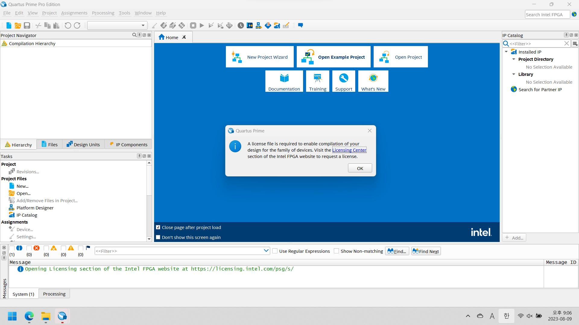

I have a trouble with a license for Quartus Prime Pro.
Recently, I applied for a license and installed Quartus Prime Pro on my PC. But it had a problem with a disk space, thus I switched to another PC.
I also downloaded and installed Quartus Prime Pro on another PC, but there was an error message regarding the license problem. For your information, my current license is 30-day temporary.
Is there anyone who has similar experiences?
Please find the error message I got from Quartus Prime Pro.
  • Hi
    Regarding your license error. Could you help to apply again a new license for your current use pc NIC ID. Use the new license and see how things go.

    You have to point Quartus to the license file you generated from the self-service licensing center (Tools menu -> License Setup).

      I pointed Quartus to the license file I generated in the previous, but failed to run Stratix10_PCIeGen3x8_DMA_18_0.
      When I tried to run it, I got a message that "Design template installation failed".
      I had no log message for it, so I couldn't run the template file.
      Could you please let me know how to handle with the above issue?

    My issue was resolved as I changed the NIC ID.
