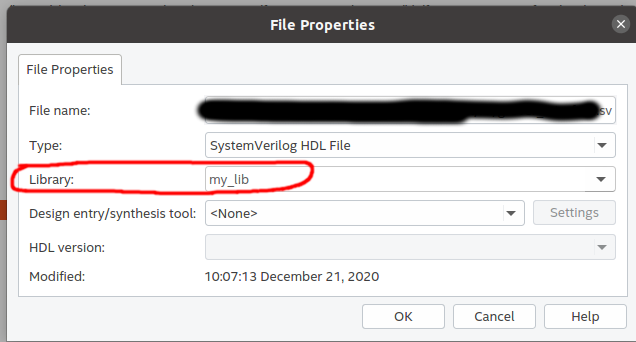

The simplest way of explaining the issue is: if a source file (.sv) is assigned to any design library, other than work, it cannot be seen by the Quartus compiler.
As shown below; if anything is in the box circled then Quartus doesn't know that file exists and gives an error.
This box is in: assignments -> settings -> files -> properties
My question is, how do I tell Quartus to go and look in my_lib to find that design unit?
