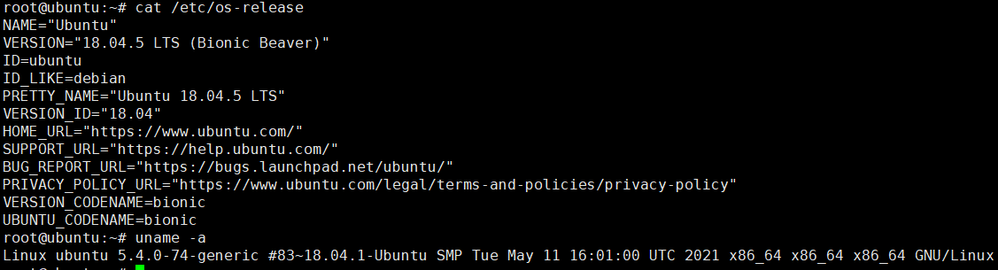

Quartus Version:Standard Edition 20.1.1
OS:Ubuntu Desktop 18.04.05

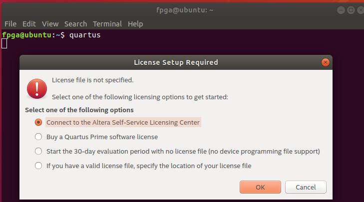

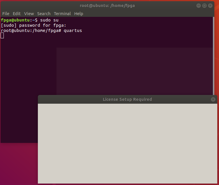

After I execute quartus, the License Setup Required Window shows "nothing".
I try to install Lite Edition, it shows nothing too.
I follow the Youtuber's steps to install quartus, the license window shows "nothing" too...

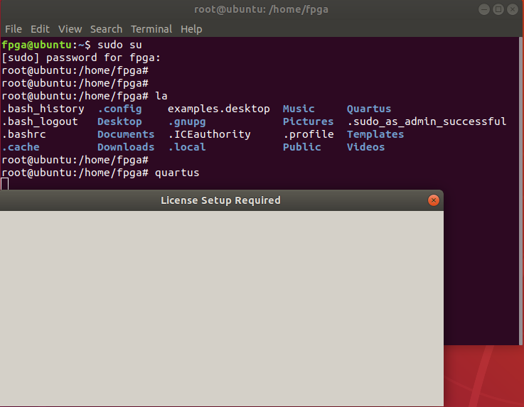

    I found the real root cause.
    Don't execute quartus software that the authority is "root". (I don't understand why user can't use root authority to execute quartus )
