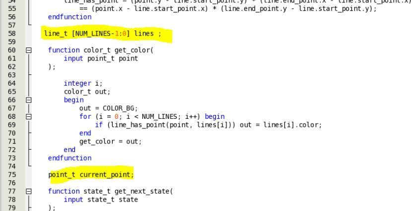

      • RichardT_altera's avatar
        RichardT_altera
        I found out if I relocate these two lines. (see attached) It seems to pass the error.
