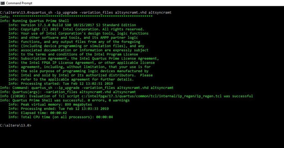

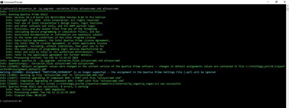

- AnandRaj_S_Intel
I have tested using Quartus 13.0 and generated altsyncram and updated IP to Quartus 17.1 & Quartus 18.1 with out any error.
Can you again by deleting db and incremental_db folders with GUI or command line.
- Select the IP core in the Upgrade IP Components dialog box.
- Click Upgrade in Editor. The parameter editor appears.
- Click Finish or Generate to regenerate the IP variation and complete the upgrade. The version number updates when complete.
or
- Use quartus_sh -ip_upgrade -variation_files <file.vhd/.v> <projectname>
this helps
