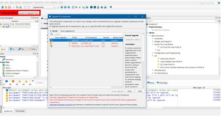

5 years agoIP Migration of DDIO_IN, DDIO_OUT and SYSCLKPLL from Stratix5 to Cyclone10 GX in Quartus Prime Pro.
I am trying to migrate an existing design from Stratix5 to Cyclone10Gx device.
Initial design was in Quartus Prime Standard Edition, however, while opening the project file in Quartus Pri...
sstrell
5 years agoThe PLL is easy: as stated, you have to delete the PLL from your design and add in the new one. I believe it's named IOPLL Intel FPGA IP.
For the DDIO, a migration flow for exactly what you're doing is described here:
https://www.intel.com/content/dam/www/programmable/us/en/pdfs/literature/ug/ug_altera_gpio.pdf
