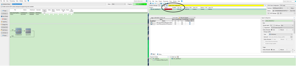

invalid jtag configuration on signaltap
Invalid jtag configuration when run signaltap, while it can be programmed successfully.
Why and How to solve this problem? Thanks!
Tools: Quartus prime standard 15.1.0 , USB Blaster II,
FPGA type : 5CSEBA2U23
- sstrell
If programming was successful in the Quartus Programmer (instead of doing the programming from the JTAG Configuration section of the Signal Tap window), Signal Tap sometimes will still have this message. Just try clicking the start analysis button as usual to see if it still works. If it doesn't, you may have made a change in your Signal Tap file that requires a recompilation, so the Signal Tap file doesn't match the Signal Tap configuration programmed into the device.
