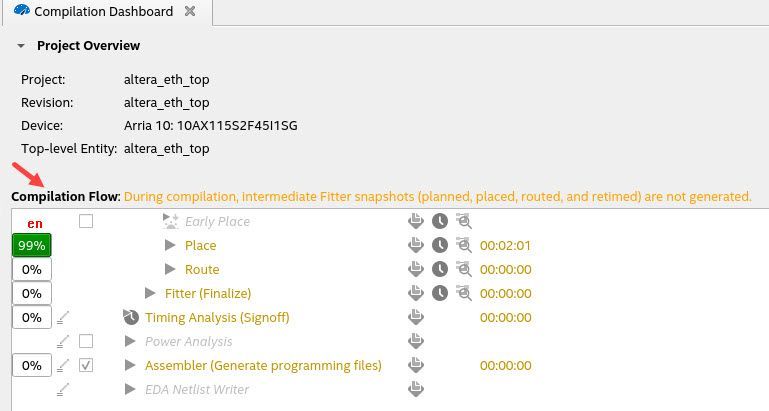

Hi All,
During the Project Compilation, I'm receiving the following message:
Compilation Flow: During Compilation, Intermediate Fitter snapshots (planned, placed, routed, and retimed) are not generated.
Why I receive such message? How do produce the Intermediate screenshots?
Thank you!
1 Reply
- RichardT_altera
To enable Intermediate Fitter Snapshots, go to Assignments > Settings, at the Compiler Settings page, enable or disable the Enable Intermediate Fitter Snapshots. (see attached).
The option is off by default.
