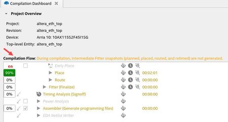

6 years agoIntermediate Fitter snapshots -> how to generate?
Hi All, During the Project Compilation, I'm receiving the following message: Compilation Flow: During Compilation, Intermediate Fitter snapshots (planned, placed, routed, and retimed) are not gener...
RichardT_altera
6 years agoHi,
To enable Intermediate Fitter Snapshots, go to Assignments > Settings, at the Compiler Settings page, enable or disable the Enable Intermediate Fitter Snapshots. (see attached).
The option is off by default.
