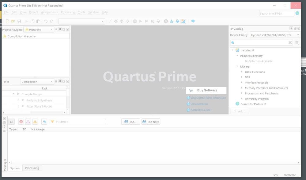

    I'm having a problem too making Quartus prime run after. i enter some basic config data:
    when i click finish after this it loops forever, if i decide to close the program it then wants to tell Microsoft. I suggest it may be something to do with i have resisted using the EDGE browser and when i gave me the opportunity to reload a I reloaded Firefox again by clicking the Firefox link on the list of browsers it gave.
    It tells me all the time that my browser is unsuitable i suspect that because I'm not using edge Quartus has been disabled in some way by Microsoft just promote use of edge.
  • tonyF1's avatar
    tonyF1
    still loping no errors, will leave it all night and see what happens.
    see attached screen shots
     is looping in this window
     and using 10% of the CPU
    It is interesting to note that it had edge take over the computer on first activation to inspect the waiting message. it locked the computer expecting me to let it have edge install. I just terminated the edge process to get control back.
    Quartus belongs to Inte,l why is MS screwing with Intel development products to prevent legitimate use by users developing products using Intel tools in fully licensed ways.
    today's nonsense has wasted many hours that could have been better spend developing stuff to run on Cyclone V arrays. After about 8 hours i cannot use Quartus prime lite in the legitimate ways it was licensed for. I even reinstalled as administrator this made no difference. Lets see what tomorrow brings if I leave it to loop all night. Think I better look for alternative products if Intel have so little regard for users to allow MS to Bully Boy customers this way.

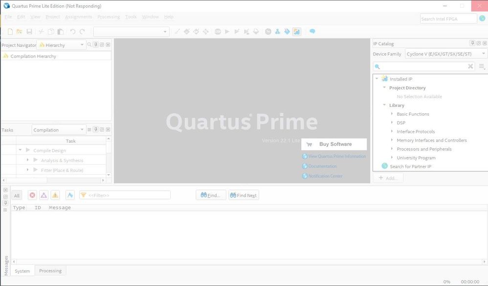

  • tonyF1's avatar
    tonyF1
    account for this then
     i downloaded Firefox again from this menu and nothing changed
