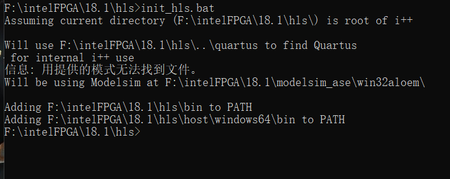

Hello, I am reading the HLS Getting Started Guide. I encountered a problem where I did not return the path to VisualStudio after initializing hls. As shown in Figure 1.But I read that it should look ...

please follow this document. it's a visual studio installation issue. please try to reinstall it and don't forget to install the c/c++ compiler and try to compile hls project.
