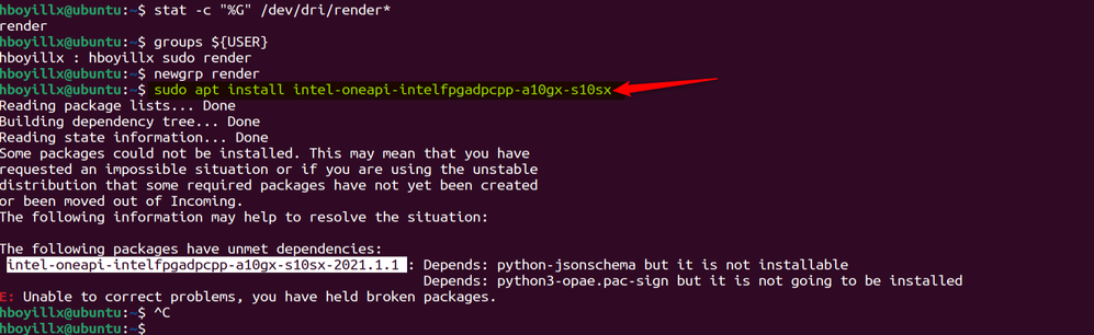

Then we tried to install from the APT-Package Manager the following package:
intel-oneapi-intelfpgadpcpp-a10gx-s10sx.
However this package seems outdated since its dependencies are broken.

Then we tried to install from the APT-Package Manager the package:
Which didn't work either.

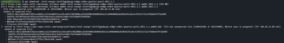

We have provided in the attachment :
-The error logs that are yield to us when we try to install the pacakge intel-oneapi-intelfpgadpcpp-a10gx-s10sx on our Ubuntu 18.04.
