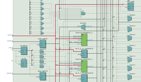

7 years agoInfer dual port RAM without read during write bypass logic
I am attempting to infer a single clock, dual port RAM without any bypass logic. I am having problems with synthesis, it seems to add a lot of bypass logic that wasn't there when I used the megawizar...

I ended up just using an altsyncram definition. I dont think quartus is able to infer such a complicated ram.
