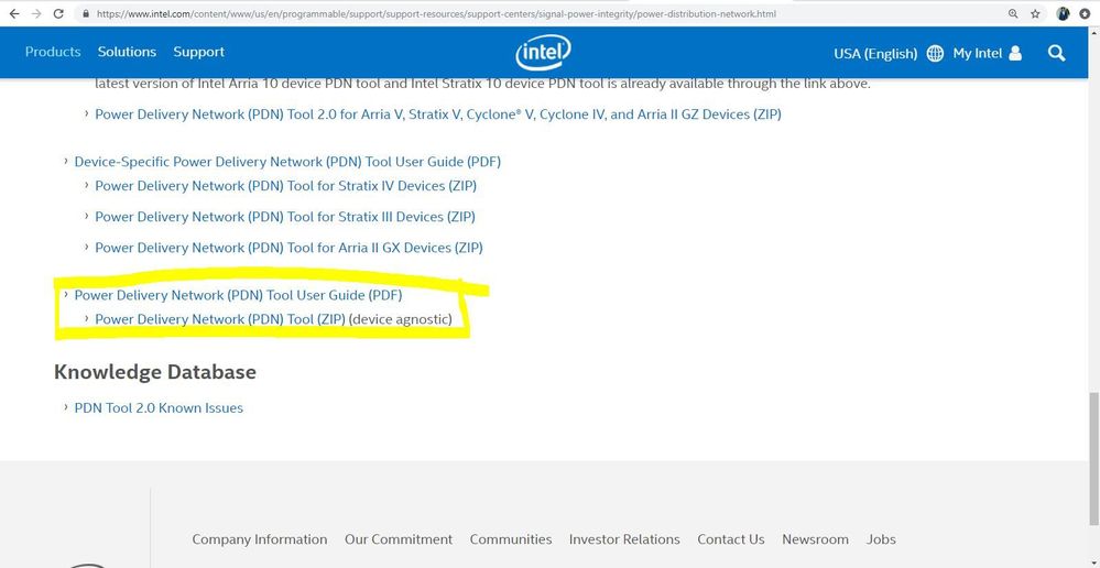

For the Intel Cyclone 10 LP devices you may use the Device Agnostic Power Delivery Network (PDN) Tool, refer the below solution link & training.
https://www.intel.com/content/www/us/en/programmable/support/training/course/opdn1105.html

For the Intel Cyclone 10 LP devices I would recommend to use the Device Agnostic Power Delivery Network (PDN) Tool,
Please refer the below links,
https://www.intel.com/content/dam/www/programmable/us/en/pdfs/literature/ug/ug_pdn.pdf
