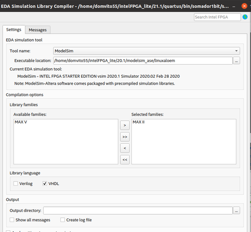

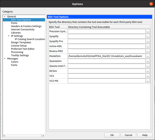

3) I've put the right path to ModelSim on Quartus Prime, and it can even recognize the version as we can see on pictures 1 and 2. I've tried 2 variations:
a) /home/domvito55/intelFPGA_lite/20.1/modelsim_ase/bin
and
b) /home/domvito55/intelFPGA_lite/20.1/modelsim_ase/linuxaloem
4) But when I try to run ModelSim from inside Quartus, it does not open! And I get the following message which is pretty odd, as I've never installed Questa, and I didn't even put a directory path for Questa.

    Have you change the path in Assignments->Settings-> EDA tool settings?

      Nop. What I did instead was step back the Quartus and the ModelSim to version 20.1, so now I can use it normally. But I could not make the previous arrangement to work.
