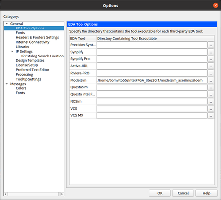

4 years agoI think it is a bug. ModelSim cannot be called from Quartus on Ubuntu
1) I have Quartus Prime Lite 21.1 installed on Ubuntu 20.04 and it is working fine.
2) I also have ModelSim 20.1.1 and it is working fine
3) I've put the right path to ModelSim on Quartus Prime, ...

4 years agoI just noticed that you used ModelSim in Quartus Prime Lite 21.1. Unfortunately, the simulation software ModelSim has been removed in Quartus 21.1 and it was replaced by Questa. https://www.intel.com/content/dam/www/programmable/us/en/pdfs/literature/rn/archives/rn-qts-std-dev-support-21-1.pdf
- domvito554 years ago
Thank you very much.
