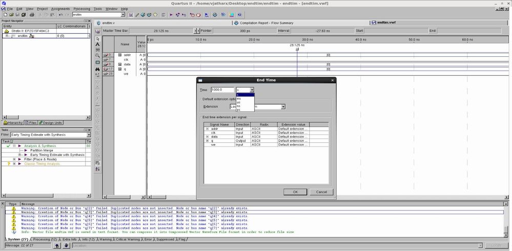

- Vicky1
Can you please check with the option Edit->Set End Time.. ?
Refer the below link for the reference,
https://www.youtube.com/watch?v=a8JAkKhxlQI
Best Regards
Vikas Jathar
