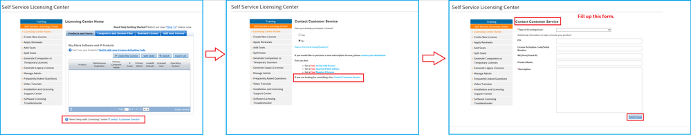

First check the license for "Nios II Embedded Processor Encrypted Output (00A2)" for that go to the 'License Setup' in 'Tools' menu of the Quartus and make sure you have "Nios II Embedded Processor Encrypted Output (00A2)" listed. If you don`t have license then need to purchase it from self service licensing center,
Please refer to the attached screen shot. Please submit the "Contact Customer Service" form in this link to request 'Nios II Embedded Design Suite License'
feature,
https://fpgasupport.intel.com/Licensing/license/contact.html
https://www.intel.com/content/www/us/en/programmable/documentation/esc1425946071433.html#mwh1410890917582

Please contact to 'customer service' as I suggested in previous post & describe the issue in 'Description' then they may guide you.
