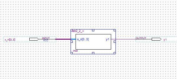

I created an element in verilog code:
module lab2_2_v
input [0:3] x_n,
output y1
wire x1 =~ x_n[0];
wire x2 =~ x_n[1];
wire x3 =~ x_n[2];
wire x4 =~ x_n[3];
assign y1 = ( x1 & x2 & x3 & ( !x4 ) ) | ( x1 & ( !x2 ) & x4 ) | ( ( !x1 ) & ( !x2 ) & x3 ) | ( ( !x1 ) & x3 & x4 );
endmodule

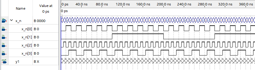

In modelsim I tried to count value "count every" - quartus crushed

You can't use count value "count every" on bundled signals in vector waveform simulator. That only works on single bit signal. Check image:
