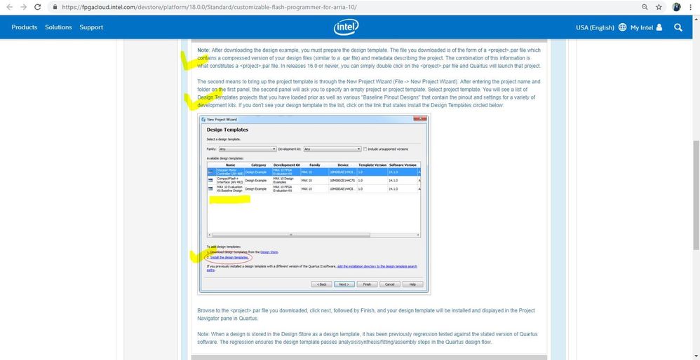

Confirm again with highlighted parts from below screenshot,
