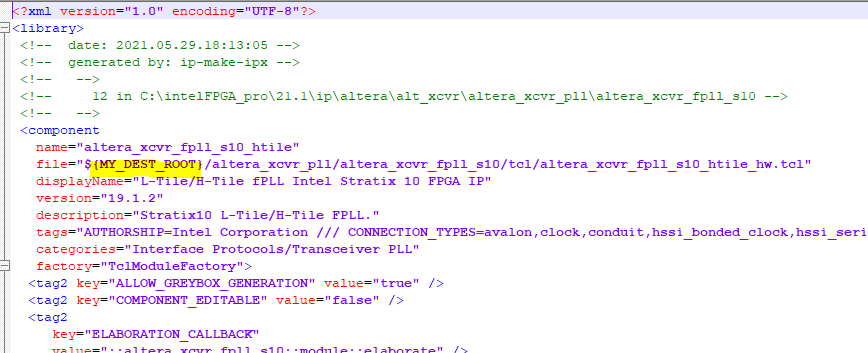

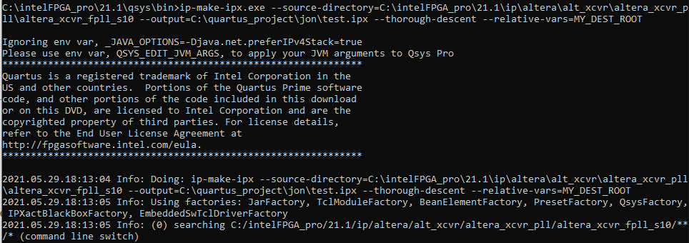

Hi @gyuunyuu
I was able to make this work on my Windows machine. One thing I noticed was that you need to reboot your command prompt after you set your env var to take effect.
I used "echo %MY_DEST_ROOT%" to make sure the is active within that shell.
Richard Tan
