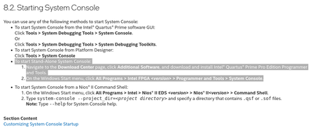

3 years agoHow to open System Console from command line?
https://www.intel.com/content/www/us/en/docs/programmable/683819/22-4/starting-system-console.html
Intel's developers don't know how to add .desktop to gnome, therefore there is no "All Prog...
