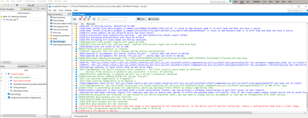

There is an error in the execution process as below picture.
I don't know what the error means ?
- SyafieqS
You can go to device and pin option, change the config mode to single image. The reason is your migrate device does not support multiple image.

- TerryC1
Yes, we change the config mode to single image. But there are other error message. We are trying to solve.
