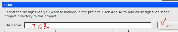

(1)Before that, could Quartus auto execute .tcl files by adding .tcl files into the project as follows picture?
